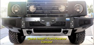

When I was shopping for my Grenadier I considered adding the factory front receiver - I use a receiver-mount winch on my three Jeeps and planned to use it with the Grenadier as well. Unfortunately the factory front receiver is only rated for moving trailers around, it's not rated for as much force as a winch can provide when getting the Grenadier unstuck.
So I ditched the idea of adding the factory receiver to the front, and decided I would need to build my own receiver as I've done for my Jeeps. I've designed and built "quick install" receivers for the front of the Jeeps which bolt in place/remove in minutes - since I only need a winch (and therefore the front receiver) when I'm on an expedition, I can install the receiver and winch just for that expedition and remove it for daily driving when I return home.
I've designed a quick install front receiver for the Grenadier and I am getting ready to build it. These are the main materials that will be used... a Reese Class IV (10,000 lb.) hitch for some pickup and a piece of 3/8"-thick steel angle:
It'll go together approximately like this - the steel angle will be cut into brackets that attach using the bumper bolts that are behind the plastic trim on either side of the center of the bumper. The Reese hitch will be cut to fit between the brackets and welded to the brackets; there will also be tabs in the back which have holes for bolts that go into factory holes on the top of the bumper into the frame. I'll have it powder coated once it's built.
Installation will be simple - remove the two plastic trim pieces (4 T-30 screws on each side), remove the 4 bumper bolts into the frame on each side, position the hitch to replace those bolts and tighten them down. Should only take a few minutes and removal will take about the same time.
I'll install it just for expeditions where I might need the winch and remove it when I get home, same as I do with the quick install receivers on the Jeeps.

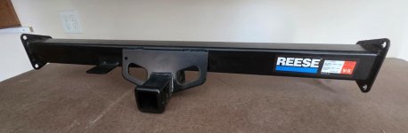

Super helpful (as always). Do you recall the exact model Reese you used? Looks like they have a ton listed on their website that are probably mostly the same (although some seem to be straight and others slightly curved) - guessing the main difference has to do with the attachments on the side (which don't matter here anyway).
I'll be using a Reese 37016 for this project.
I chose it because I wanted a heavy-duty class 3 or 4 hitch (this one is a class 4) with a straight crossbar and a receiver below the crossbar. I found this one on FB Marketplace for $100 in new never-installed condition.
I should be starting the fabrication in the next month or so; I've been too busy with other priorities to have time for this project yet. Finished receiver will look like this when installed:

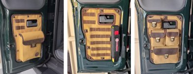

After posting about the preproduction bag that fits in the compartment in front of the jack the other day, I got a number of questions about other storage accessories that were in the photos, so here's more info on two of them. There were questions about the pocket panel on the inside of the narrow rear door. There are several options for that, I've got the four-pocket option installed in my Grenadier. There's also a version with a single large pocket, and a MOLLE panel version. www.overland-outfitters.com/store/p86/Narrow-Rear-Door-Storage.html#/ and https://www.overland-outfitters.com/store/p90/Narrow-Rear-Door-Storage.html#/. All of these are available in either tan or black and install using the factory hardware on the door.
Also got some questions about the First Aid Bag hanging on the back of the seat. That one can hang there or on the wide rear door panel; it's got pockets inside to organize all of the medical supplies for fast and easy access. https://tinyurl.com/3m78w3hk https://www.overland-outfitters.com/store/p88/Grenadier_First_Aid_Bag.html#/

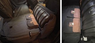

I find it very inconvenient that the back seat won't fold down with the headrests in place. In my 2013 Wrangler, when the back seat folds down, the headrest automatically hinges so the seat won't be prevented from folding down by the headrest hitting the front seat, but the Grenadier's headrests are much more primitive. Since I almost never have back seat passengers, I could just remove the rear seat headrests, but I actually use the headrest posts to hang things, so to fold the seat down, not only do I have to remove the headrests, but the bags/pouches hanging on them have to come off too.
The problem:
So here's what's on my sewing table right now - smaller "headrests" that don't interfere with the front seats when the back seat folds down.
I'm making three. They're a direct replacement for the factory headrests, but are small enough to allow the back seat to fold down.
In the rare event I need to transport people in the back seat, I'll swap one or more factory headrests back in, but for maybe 360 days per year, these mini ones will be perfect.
For anyone interested in the details... the Grenadier headrests have 14mm posts, which are not very common. They're more common in European-designed vehicles, so I went to the U-Pull junkyard with my micrometer in hand and discovered that VW Jetta's have 14mm posts. The spacing between them is not the same as the Grenadier's spacing, so I modified that and then build a small roll of padding (pipe insulation like you might use to insulate the copper pipes coming out of your home water heater) and sewed a tight-fitting cover.
I finished the remaining two "mini headrests" this afternoon...
These enable the back seat to be folded down with the headrests (and the attached bags/pouches) attached.
Obviously these don't provide much support in the event of being rear-ended, so as I said in the last post for the very fews times each year that I carry passengers in the rear seat, I'll swap the factory headrests back in, but for the rest of the days, these work exactly as I planned - the hold the bags/pouches in place while allowing the seat to be folded down.
