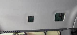

There are four 8mm threaded holes behind the cargo area headliner, two on each side behind the clip-in hole covers. In this photo I've removed the covers on one side and the threaded holes are visible:
The covers can remain in place when the L-tracks are mounted, so holes for the L-track mounting screws need to be made in the covers. I made this template to accurately locate the holes.

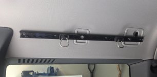

The surface of the cover plate is recessed about 3/16", so to mount the L-track without stressing the plastic of the covers, 3/16" - 1/4" thick spacers are required. You could use a stack of a few washers, but I made spacers by cutting them out of 3/16" plastic with a hole saw.
Next decide how long you want the L-track to be. The threaded holes in the Grenadier are only about 10 1/2" apart, so for maximum L-track strength, the L-track should probably only be slightly longer than that, maybe 15-16". I decided to make mine longer as a test (24"), with the idea that only lighter loads would be placed on the longer unsupported end of the L-track. I may shorten it later if the extra length towards the back isn't suitable for supporting anything. Also at the front end, the L-track hides the factory mounting slot, so if that's to be used for something else, the L-track will need to be shorter.
The L-tracks get mounted with 8mm machine screws. The mounting holes in the L-track will not match the spacing of the holes in the Grenadier, so you'll need to drill holes at the appropriate distance. I used one of the holes that was already drilled/countersunk in the L-track (although I had to enlarge it to fit an 8mm screw) and unfortunately the second hole fell in the narrow part of the L-track so I wasn't able to use a countersunk flathead screw there because of the large size of the flathead. I used an Allen cap screw there, which means that an L-track clip can't go in that location. Shouldn't be a problem though, there's plenty of length on the L-track for attaching clips.
Once the holes are done, the L-tracks install easily - place a spacer under the L-tracks at each hole location and fasten the L-tracks to the threaded holes in the Grenadier with 8mm flathead screws, 25mm long or so. The Allen cap screw is in the forward hole in these photos.

I made some refinements to the overhead L-tracks - I shortened them to 20", partly to clear the factory attachment points in the front and partly to reduce the rear overhang that's unsupported. I also did a little more work on the drill press to make it possible to use flathead machine screws in both locations.
I plan to make an overhead cargo net to attach to these, as well as some cargo bags, or possibly a rigid shelf.

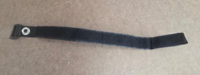

In the cargo bag hanging on the ladder I carry some 2" wide ratchet straps and in the pocket panel inside the rear door I carry some 1" ratchet straps, but neither of those works very well for a narrow load like this so I use Velcro tie-down straps. There are four of them in the photo above, two securing the load to the rack and one each on the far ends to keep them from flopping around. I used short ones for this load, here's one:
They work very well for narrow loads like this. A search on eBay or Amazon with the term "hook loop tie down" will turn up a quite a few in sizes up to 36" long.
