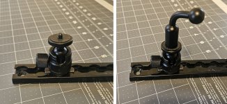

I've been looking for a way to mount accessories on the dash in front of the steering wheel. The "tray" there is so shallow that it's pretty much useless, so I looked for a solution to replace the tray. I'm aware of the mounting systems that go just below the center display but I think accessories mounted there will get in the way of the console controls/air vents, etc. so I wasn't looking for something like that. I found a few commercial solutions that go where the tray is but most were priced from $80-$150 depending on which/how many mounts you bought with it and almost all them required making up to 8 screw holes in the dash so I decided to design something better/cheaper/less invasive. In keeping with the Grenadier's copious use of L-track, my solution is a length of L-track (<$20) and a mounting method that uses the existing holes in the dash that the factory rubber tray mounts into. I found the track on eBay, a 2' of piece for $18.95 with free shipping. I cut it to just fit on the flat area in the recess after the rubber liner was removed.
Power for any accessories mounted on the track will come from the 4-output USB port I added below the dash; short USB cables will connect there, so I won't have long cables dangling everywhere.
Right now I've only got my Garmin GPS on the track but I'll add other accessories over time, like my cell phone, which is currently in a windshield suction mount/charger or maybe a dash cam.
A few more mounting options I haven't put into use yet - a swivel camera mount (for a dash cam maybe) and a ball mount on top of the camera mount.
This last photo shows how I secured the L-track to the dash - I slipped U-nuts into the existing holes in the dash that the rubber tray plugs into, then I used #8 trim screws through the bottom of the L-track into the screw holes in the U-nuts, so the only "damage" to the dash are the small screw holes next to the factory holes and if I ever swap L-track out and put the rubber tray back in those two small holes will never show. I picked up an assortment of U-nuts at Harbor Freight and that assortment had some in an appropriate size for this application.

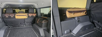

This morning I installed the final design Grenadier cargoside bag and its mount. The bag is an adaptation of one Overland Outfitters makes to go in the bed of the Jeep Gladiator; for the Grenadier I've modified to mount differently and a carry handle has been added. The craftsmen at OO are making me a preproduction sample of the bag which I'll get from them next week and it will be essentially the same as the one that's shown in these photos. The bag hangs on a zipper mount - it zips in place and unzips to remove. This mounting method has been well tested in the OO Jeep products for quite a few years and it's capacity and reliability is excellent. For the current testing, I've got a 35,000-lb. recovery strap and two D-ring shackles in the bag as a typical load that might be carried in the bag. The zipper mount attaches to the side panel of the Grenadier with no screws or adhesive and installs/removed easily and quickly. Unless my testing shows the need for improvements and assuming the OO sample I pick up next week is the same as the one I'm testing, I'll let OO know that this is ready for production. The zipper mount is the same as OO uses for their seat back bags, so all of those bags can also now hang on the side of the cargo area, including their First Responder First Aid Bag, Tool Bag, 15" Zip & Go Bag, Messenger Bag and the new bag for the rear door cargo panel (I'll post photos of the preproduction version of the rear door cargo panel as soon as I take and edit the photos).
SaddlebagTest1a.jpgSaddlebagTest1b.jpgSaddlebagTest1c.jpgSaddlebagTest1d.jpgSaddlebagTest1e.jpgSaddlebagTest1f.jpg
View attachment 875441View attachment 875442View attachment 875443View attachment 875444View attachment 875445View attachment 875446
One detail I should show that wasn't on the bag at the time I took the photos... normally one will hang the bag with just the zipper, and for daily driving and moderate trails this works great and makes for very quick removal of the bag should you need to take it with you. But for extreme trails where the bag may move a bit when hanging just on the zipper, the bag has d-rings on each side that can be used with a strap (which will be supplied with the product) to secure the bag to the side panel. The zipper is plenty strong enough to hold the loaded bag but the straps prevent any movement on extreme trails.

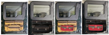

One of the preproduction samples the craftsmen at Overland Outfitters made for me last week is the rear door pocket panel design. This replaces the factory plastic panel on the door and installs with the factory screws. It's got 4 fixed pockets plus a removable cargo bag that uses the recess in the door that the factory compartment uses but doubles the cargo space available there.

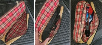

The removable bag is very roomy, here are a few photos showing the inside of the bag - in one of the photos the factory tool kit is in the bag and in another photo a quart of oil and my NATO-Anderson adapter are inside and in both photos you can see there's lots of extra room in the bag for more.
The removable bag attaches to the panel with a zipper, and that zipper is the same as the zipper mounts OO uses for the seat back and for the Grenadier cargo area side, so here are photos of the bag hanging on the seat back and on the cargo side. I expect OO will make the bag available separately in case someone wants multiple bags that can hang in all 3 places.
OO would plan to offer this in tan as shown and in black, I've attached a series of (poorly) colorized black versions and photo-edits showing what the First Aid bag would look like with the different colors.

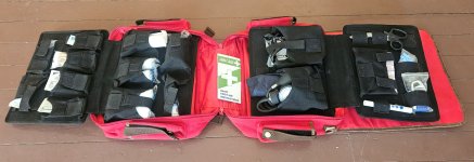

The First Aid Bag option is underway as well, the OO craftsmen will have a preproduction sample for me in two weeks. It's the same size/shape as the removable bag shown in the photos, but of course it's red and the inside; it's zippered so that it can open and lay flat and has pockets to organize the first aid supplies inside, very similar to their First Responder First Aid Bag shown below:
I've got a few very small tweaks to suggest for the production version but it's pretty close to final. It's expected to be in production in time for the Overland West event in May. Anyone going to that event?
