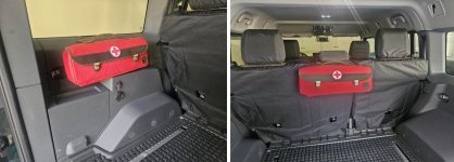

The First Aid Bag for the large rear door panel is almost identical to the cargo bag that zips into the same panel but it's got some special features for first aid supplies. It zips open to lie flat and inside are small and medium pockets for the supplies, behind those are larger pockets, and a center panel with elastic loops to hold even smaller medical supplies. Unlike most first aid bags, the organization inside this one is designed so one can find the needed supplies quickly in an emergency when time is of the essence.
For reference:
When I get home I'll install both of these in the Grenadier and I'll also load the first aid bag with supplies to show how the inside organization works. BTW it also zips onto the attachments on the seat backs and the cargo sides so if all one needs is a great first aid bag it can be hung in either of those places instead of on the rear door.

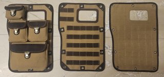

While at the Overland Outfitters factory last week I asked them to sew prototypes of two styles of panel for the small rear door. One version has pockets and it matches the pockets on the large rear door panel I posted the other day. The other version has a MOLLE/PALS grid. I'll install and photograph both of these panels when I get home and post more photos then.
They also made an "unfinished" panel for the small rear door - the reason for the unfinished one is so that if other ideas come up, I can sew that one to suit whatever the idea is, which saves me the time and trouble of sewing the base panel from scratch. After I test these in the Grenadier, I'll make a recommendation to OO about which if any versions should go into production.
And OO's first Grenadier catalog has been printed, I picked up a couple of copies while at the factory.
I'm back from the Overland Outfitters factory with some new pre-production samples to test. I brought back new pocket panels for both rear doors, a new First Aid bag to zip into the wide rear door pocket panel, a MOLLE panel for the narrow rear door and a cargo side bag. I tested them all for fit in the Grenadier today and after that I told OO that I think they're ready to go into production. The samples of the panels for the doors were done again in tan with brown leather; in production they would be offered in both tan and black. The first aid bag has pockets for medical supplies inside and it's designed to open to lay flat for easy and quick access to supplies. I've attached two photos of it open, in one photo it's still hanging on the rear panel and in the other it's sitting on the cargo area floor. It also can hang on the seat back or on the cargo side, photos of it on both locations are included.

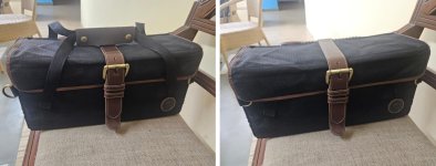

Picked up a preproduction sample cargo-side bag at the Overland Outfitters factory last week. It's basically identical to the prototype I've been testing for the past few weeks; I made the prototype and the craftsmen at OO made this preproduction sample. Since it's identical to what I made, I don't need to do any further testing so after installing it the other day I told them it's ready for production if they want to offer it. This bag hangs/removed very quickly with a zipper attachment to the cargo side; it also has a carry handle so you can take it with you if you need to.
Also I'm testing a Ladder Bag. It's an adaptation an of Overland Outfitters bag called the Spareside Bag which is designed to hang on the side of the spare but because of the configuration of the spare and doors on the Grenadier, it isn't optimal there, so I altered its straps to suit hanging on the ladder. We use these bags (both the large SpareHopper and the smaller Spareside bags on expeditions - trash in the large SpareHopper and recycling in the Spareside bag. I keep the large SpareHopper on the Jeep (and now on the Grenadier) during daily driving as well - we live in a state where stores no longer provide bags for purchases so I keep a bunch of tote bags in there for shopping.

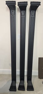

I need three load bars for the Grenadier - two for the main flat area of the roof to hold the Garvin basket, and one bar for the front to hold the front of the extension basket with the solar panel. I came across a person whose Grenadier came with factory rack bars and he decided not to use them, he offered a nice price so I sent him the money and he shipped me the rack. Unfortunately most likely due to an error at the pack & ship place he used and not his fault, I did not receive one of the legs. He offered to make good somehow, so I checked with Rhino and they told me that they don't make the legs - Ineos makes them, so I'd have to go to the dealer. I then called my local dealer (RDS in Devon, PA.) and asked them if replacement parts were available. It turned out that due to some warranty work (I think), they had an extra leg just lying around and they told me I could have it. I jumped in the Grenadier and headed for RDS. While I was there I showed them what I was planning to do and asked if they had enough random parts in their attic to make up the third crossbar I needed so they rummaged around for a bit and came up with almost everything to make up a third bar except for a few hardware bits (mostly bolts I was able to source easily). They sold me the parts for the third crossbar for an extremely reasonable price so now I've got the three crossbars I need.
All of the parts. The legs are in the tote bag.
All 3 bars assembled:
