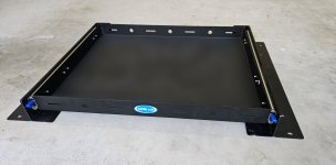

Two weeks ago I wrote that I've been working with MORryde on a cargo slide for the Grenadier: https://forum.expeditionportal.com/threads/outfitting-my-grenadier-trialmaster.247640/post-3212913
They had sent me a preproduction sample; I installed and test it and posted about it. Yesterday a big box arrived from MORryde with a "production candidate" cargo slide - meaning unless something is found to be wrong with this one, it's ready for production. I installed it yesterday, it went in very quickly and works as intended. MORryde also asked me if I would take photos to document the installation process for them to use in their instructions for the product, so I did that and I'll send them a draft set of instructions for them to edit and finalize. They tell me the retail price for this will be $400 or less and they're shooting for "less." They haven't given me a release date other than "soon." The same slide is also designed to fit in the JKU and JLU Wranglers so I have to install it in my JKU tomorrow to do photos for the installation instructions.
I got a comment last time I posted questioning that this slide wasn't the full width of the cargo area. The answer is that this is designed to fit the JK and JL Wranglers, the Bronco and the Grenadier and the Grenadier's cargo area being wider, the slide doesn't quite fill the space. Personally I like this width slide, the real estate on the sides is not useless, I would use it for things not needed frequently. And for some people price is a factor, the leading full-width slide for the Grenadier is $1329.95, so this one from MORryde is $1000 less (!) than that one, and since fridge-only slides typically range from $200-$300 for a decent one, the MORryde slide isn't much more than a fridge-only slide. To me the MORryde slide seems like a very good compromise between a very expensive full-width slide and a fridge-only slide. Also the MORryde is very easy and quick to remove/install so if you only need the slide for some excursions, you can remove it when not needed for daily driving.

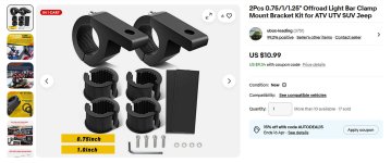

I'm experimenting with the rooftop circuits; my first experiment is a campsite light. I found mounting brackets to fit the roof rails on eBay (https://www.ebay.com/itm/135462984283):

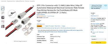

...and got some DTP connector pigtails on Amazon (https://a.co/d/aPmW4OX).
RooftopDTPPigtails.jpgnd a wing nut (so it can be installed only when needed). I temporarily connected the LED leads to the DTP pigtail with clip leads for this test. Works fine. Now to decide what lights to use for campsite lights and wire them better than with clip leads.

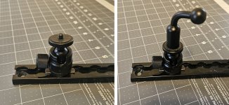

A few weeks ago I posted about adding a section of L-track to the dash mount things like my GPS: https://forum.expeditionportal.com/threads/outfitting-my-grenadier-trialmaster.247640/post-3213932. It's worked out fine and I've been experimenting with other types of mounts that can attach to the L-track. A RAM ball mount fits and secures to the L-track just fine and there are lots of things that can attach to a RAM ball. A swivel camera mount also works well (perhaps for a dash cam or a GoPro?) - I used a shortened L-track stud to attach it. The only swivel mount I could find has a 3/8-24 (fine) thread and the only L-track studs I have on hand are 3/8-16, so I retapped the thread inside the swivel mount to fine thread. Maybe a swivel mount with a fine thread or an L-track stud with a course thread could be found but if not, running a fine thread tap into the hole is pretty easy. Lots of options for mounting things.

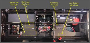

I've been working up a list of spare fuses I think I should carry and I'm frustrated by access to many of the fuses. Many of the fuse boxes are hidden under the plastic panel under the rear seat, requiring quite a bit of disassembly to get at them. That's dumb - you need multiple wrenches to check if a fuse has blown?
A few examples of fuses I think might be good to carry:
- Fuses for the roof power points, in the Accessory Pre-Fuse Box.
- Fuse for the US-spec 400-watt inverter, in the Interior Pre-Fuse Box.
- Fuse for the 350-amp rear NATO plug, in the Accessory Pre-Fuse box (almost accessible, but the cover to that box can't be completely removed due to the plastic panel covering one end of it).
Those are only a few examples, there are other fuses I'd like to carry that are in those same fuse boxes.
I picked up an ATM fuse assortment at Harbor Freight for less than $6 and it has every value ATM fuse used in the Grenadier except 7.5a. I had some 7.5a fuses from a similar assortment I bought years ago for one of my Wranglers and since the Wrangler doesn't use that value I moved those fuses to the HF assortment for the Grenadier.
I also got spare 350a Z-Case fuses for the NATO outlet in the rear, I figured if I'm winching out of a situation using that outlet and a fuse blows I wouldn't want to be stranded because of that. While I was at it the place I ordered those from also stocked the correct Z-Case fuses for the Power Distribution Module (125a) and the Interior Electrical Centre (150a) and while I never expect that those fuses will blow, since I was paying the shipping to get the 350a fuses anyway I added those to the order.
There are a few other Z-Case fuses I want to get but the place I ordered from didn't have the right values with the right hole size so I'll keep looking.
I haven't removed the plastic panel under the seat yet, so if it's quick and easy someone can tell me that :). But assuming it's not quick and easy, has anyone thought about making holes in the panel to provide access to the fuse boxes? Seems like that wouldn't compromise too much of the purpose of the plastic panel in protecting the wiring underneath. I'd appreciate your thoughts on fuse access, you can see in this marked-up photo how inaccessible some of the fuse boxes are...
