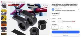

DIY Jerry Can Carrier... I mounted a jerry can tray to the ladder using a two pairs of clamp mount brackets I found on eBay (<$20). Quick project, all that was really necessary was drilling a few new holes in the back of the jerry can tray to line up with the brackets. Many jerry can trays are not tall enough to reach between two rungs of the ladder, so if you have one of those trays you'll probably need a few extra bits of hardware. This tray is from MORryde, it's part of a side-mount design for the Wrangler that I did for them a few years ago. Also I could have mounted the tray one rung lower, but since the bottom rung of the ladder doesn't stick out as far as the middle two rungs, spacers would be required between the brackets and the tray on the bottom rung, it wouldn't be a big deal to make spacers for that.

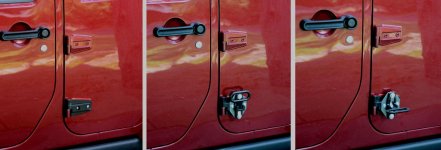

When I first bought the Grenadier, I had the dealer remove the ladder because a ladder on the rear didn't seem as useful to me as the hinge steps I had on the JKU. Later I reinstalled the ladder to use it for various cargo purposes as I've posted recently.
I may design a version of my hinge steps for the Grenadier after I have some experience carry more things on the roof rack, but because the door sills are higher than the JKU sills I may not need the steps. If I decide I do need a little more height for accessing things on the rack, I'll make some steps like the ones I made for the JKU - I like the single hinge folding step design much better than the commercial two-hinge design...
