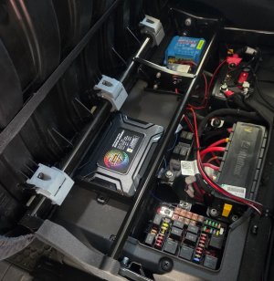

Here I'll just post a few thoughts about installing the system in a Grenadier, but there's a lot more detail in the full review linked above.
The best place I've found to mount the control box in a Grenadier is under the back seat just over the battery. The plastic battery cover is a little flimsy for this purpose so reinforcing it with a metal bar across the screw locations might be a good idea, but the good news is that the supplied battery cables are more than long enough for this location, and the wire to connect the switch panel is also long enough to reach from the control box to the dash.
For more detail please visit the full review in the Jeep section: https://forum.expeditionportal.com/...circuit-knob-switch-panel.250524/post-3244648

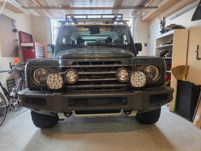

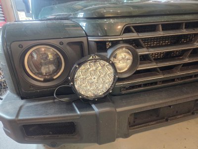

Another Auxbeam product... Auxbeam has a very comprehensive range of LED lighting options. A while back they sent me their 9 Inch 15,000 Lumen Spot Beam LED Driving Lights which I installed on one of my Jeeps and wrote a review https://forum.expeditionportal.com/threads/barn-door-for-jk-factory-hardtops.127687/post-2940341). I kept them on the Jeep for a while but the way I use that Jeep almost never required that much lighting so I removed them and kept them for some future use. Yesterday I posed them on the Grenadier to see how they might fit/look there.
Posed on the bumper:

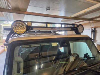

Might be better up on the rack. In this next photo they're sitting on the roof because that was an easy way to pose them there for the photo, but they would mount pretty easily on the front of the rack, I could replace the smaller lights that are already mounted (which are also Auxbeam products). There's enough room up there that they wouldn't stick up above the rack so no loss of overhead clearance, they would clear the roof, and there still would be enough space between them for my solar panel which mounts under the rack and pulls out for full access to the sun.
Mostly I posed them on the Grenadier out of curiosity, I'm not sure I need the extra lighting on that vehicle right now either.

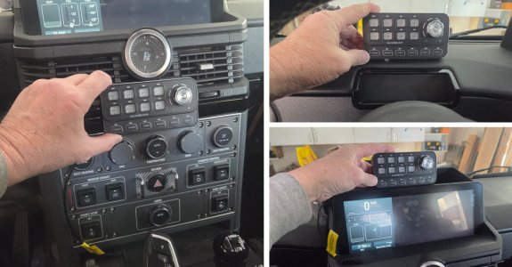

Experimenting with ideas for mounting things on the center dash... I made these prototype brackets out of aluminum angle this morning. I haven't trimmed the sides or tops yet, my first goal was to get the fit on the dash correct. The tops and sides can be trimmed for whatever I decide to mount here.
Not sure where I'll go with theses brackets - in the top two photos a piece of L-track is posed in place between the brackets, that's one way these could be used.
One of my first projects after getting the Grenadier was adding L-track on the dash in place of the shallow and almost useless rubber tray in front of the driver; I've been using it for the past year for my GPS.
At this point it's just an experiment to see what the possibilities are.
