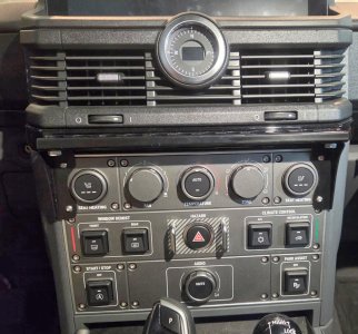

Experimenting with ideas for mounting things on the center dash... I made these prototype brackets out of aluminum angle this morning. I haven't trimmed the sides or tops yet, my first goal was to get the fit on the dash correct. The tops and sides can be trimmed for whatever I decide to mount here.
Not sure where I'll go with theses brackets - in the top two photos a piece of L-track is posed in place between the brackets, that's one way these could be used.
One of my first projects after getting the Grenadier was adding L-track on the dash in place of the shallow and almost useless rubber tray in front of the driver; I've been using it for the past year for my GPS.
At this point it's just an experiment to see what the possibilities are.

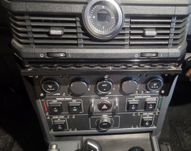

I finished the center dash mount brackets this morning and installed a piece of L-Track.

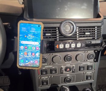

I tried a phone mount and an Auxbeam 4-switch panel on the L-track, not sure where I'll go with this or if I'll use it at all, it's just an experiment at this point.
If people are interested I can post a full-size pattern for the brackets. They can easily be DIY-made out of 1/16" x 1" aluminum angle that can be found at a Home Depot or many hardware stores. Tools required at a minimum would be a hacksaw to cut the angle to length and to rough cut the curves, a file to smooth the curves and a drill to make the holes.

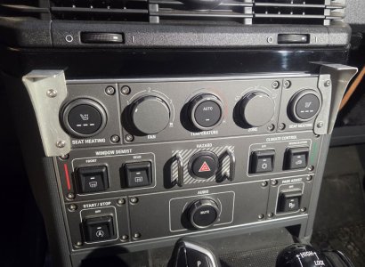

The final brackets before painting:
L-Track attached:
Auxbeam 4-switch panel mounted on the L-Track:
And added a phone mount. Since I'm left-handed I definintely won't mount my phone here, I keep it on the other side of the steering wheel mounted on the L-Track on the dash, a photo of that L-Track is in the prior post.
