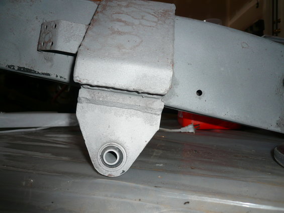

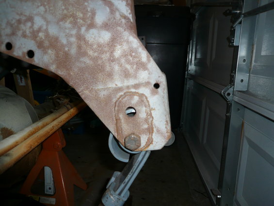

Check the pictures of my chassis (Military 109) so you can see compair the difference on your 109 Jim if you want.
I am using the Military shackles on mine but then i have the correct chassis as well, and with the Toyota diffs and tranfercase i am in a totally different boat.
Front
Rear
Never mind the rust on the front of the frame, i will have the fixed once the fabrication is done.
