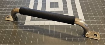

My last post reminded me that I wrapped a Jeep CJ grab bar as an experiment a few years ago. The stock bar:

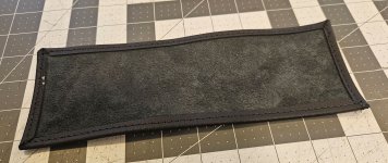

I grabbed a few materials from Hobby Lobby - some leather and some padding:
I cut a rectangle of leather and hemmed it on all fours sides on the sewing machine so that it would just wrap around the bar without the two sides touching (they would be pulled together by the final stitching), this is a photo of the back side:

A custom leather wrap for the Grenadier grab bar might be nice, does anyone know how to remove the Grenadier's grab bar? It would be a lot easier to do the final stitching at the sewing table rather than with the grab bar in place in the vehicle.
