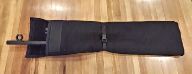

Back to the ground anchor topic from the prior post... here's another way a ground anchor could be made - when I'm on the trail I carry 4 aluminum sand ladders. They could be adapted to be ground anchor plates, which would eliminate having to carry a specific ground anchor plate - only the stakes and the bolt-on attachment point for the sand ladders would need to be carried. Here's a quick concept sketch, the red lines are stakes and I've drawn in an anchor point that would bolt to the sand ladder:
I liked the concept so I built one:
The parts that bolt together and to the sand ladder:
I tested it in the backyard; I haven't been stuck on a trail and needed it yet though:
The anchor point and bolts store in my recovery bag and for the stakes I made a separate bag:
This is now part of my standard recovery kit.
