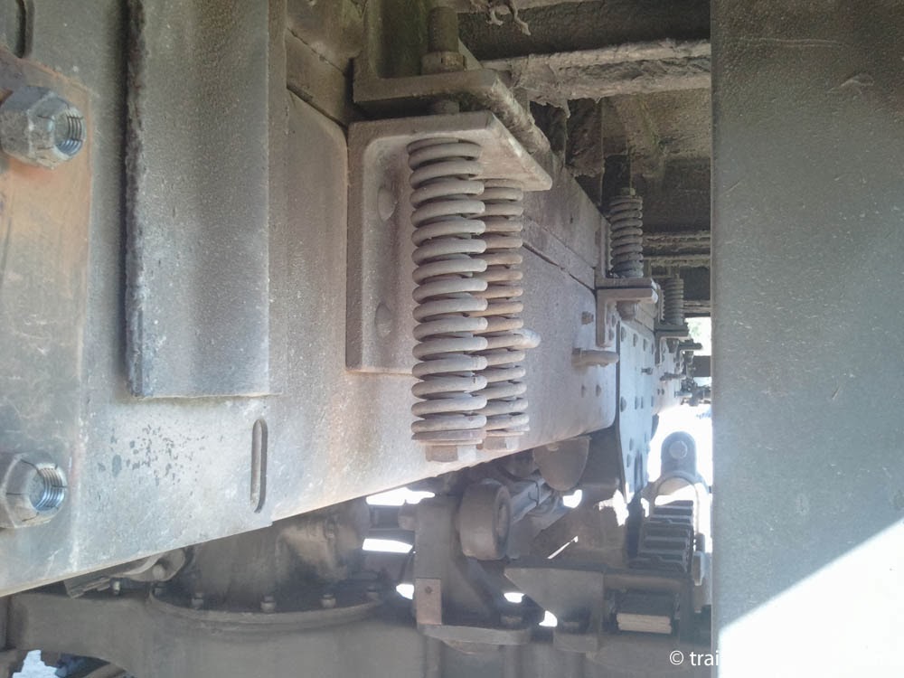

I am building a box on the back of an Isuzu NPS 300 - like a canter. I have used spring based mounts like Skifreak's but have fish plates (rigid plate) mounts at the back where there is essentially no twist b/n the sub frame and the chassis. This gives strong front/rear location. There are 3 spring mounts on each side. I used custom made springs that have 50mm possible compression at 20kg per mm. My initial loading is to compress the springs 15mm leaving 35mm movement for the relative movement.
How did I come up with these numbers? I looked at other trucks that had spring mounts, played with valve springs to see what they did, and then found that one company was using 30kg/mm on their mounts. I thought this was too high when you consider the loads at possible chassis/sub frame separations and went for 20kg/mm.
As said above none of this is an exact science and some playing around is necessary as well as backing your own judgement. If I have it totally wrong then something will break! I will then have more data to work with !!!!!! I have all digits crossed that I am not too far off.

Fish plates are actually an ADR requirement here, I didn't read the Truck Body ADR's until I'd almost finished building my box - I think they are really more to keep the subframe from dislocating in the event of an accident, but good insurance incase of a spring bolt fail. I have teflon (kitchen chopping board) on the sides of my fish plates incase of rubbing - but all good so far.
Ive done 12months touring now 36,000km and there are no loose screws or rivets and Im very happy with the subframe mounts on my Iveco 4x4 , On the front I used the standard Iveco spring washer packs and on the rear I used compression springs from Bunnings and its all working perfectly, have been over some very rough ground, there are no creaks, groans or thumps even when fully crossed up. The box on my Daily 4x4 dual cab is only 2.1m long . 2m wide so not as heavy duty as most of you are needing but if I was doing the job again, or even on a bigger rig I'd use the same method next time. Keep it Simple works for me.
Not sure if Spudboy has posted a link to his MAN 4x4 , theres a pic of his spring mounts on this page
http://daviddeere.net.au/dnnd2/en-us/Blog/Post/293 the top bracket has a hole in it (between the springs) there is a pin fixed to the bottom bracket , this locates the subframe making fish plates redundant - good idea !! there are a number of these spring sets along each chassis rail.
more here http://daviddeere.net.au/dnnd2/en-us/Blog/Post/260/Attaching-the-canopy-to-the-chassis

Quick question for the big brains on here. Looking at redoing my flatbed mounts sooner than later. I'll be using a setup similar to a M35 (springs and brackets (perches)). I've got that all pretty much dialed in (in my head anyway). My question relates to the rear attachments (left and right side). When looking at M35 schematics, it appears all that is used is a solid mount (brackets w/ bolt, no spring). At first I thought this odd, then I thought it makes sense as there really shouldn't be much flex at all at the rear of the frame as it is aft of the aft spring hanger. This rear m35 solid mount is the same regardless if it is a short of long cargo box. Don't have a M35 handy, so I can not verify this myself and I can not find a pic of the rear mount on the web. Sure would make things easier if I went this route at the rear. I was thinking I'd need a pivot at the rear, but doesn't look like it (if M35s don't need it, I think I'd be okay). Also, I will have a Superhitch Magnum hitch (4" cross tube) spanning the rear frame, so it really will be very solid back there. Thoughts? Thanks.
Here's an added bonus (in case the info is not already buried in here somewhere): The M35 part numbers for the inner and outer springs are 5360007372793 and 5360007372792. I'm starting with 8 pairs and I'll reduce from there if needed.
Well, perhaps I can answer my own question. I've looked at this pic several times (it's on here, there, everywhere), but never noticed the rear mount until now. Sure enough, it does appear to just be a solid mount (bolt and bracket) at the rear. Still, any input would be welcomed.
