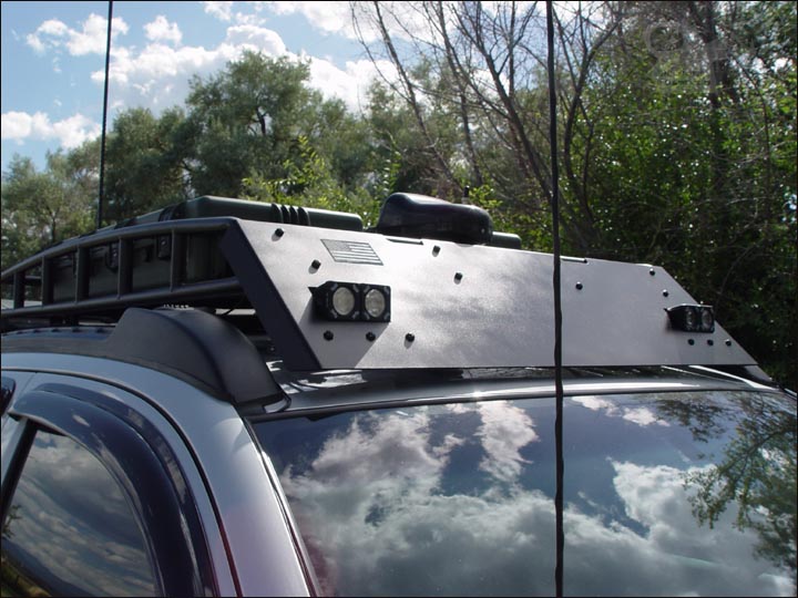

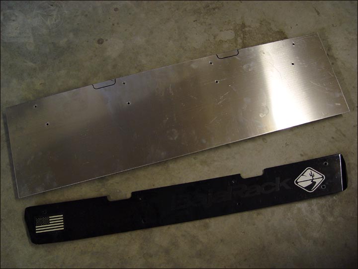

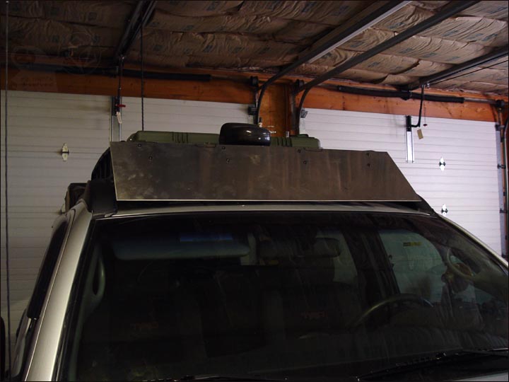

next up I fabricated a new fairing for the baja rack!
I scrounged up some nice .125 aluminum sheet and transfered the hole pattern etc:
test fitting:
most of the fab work done, ready for paint:

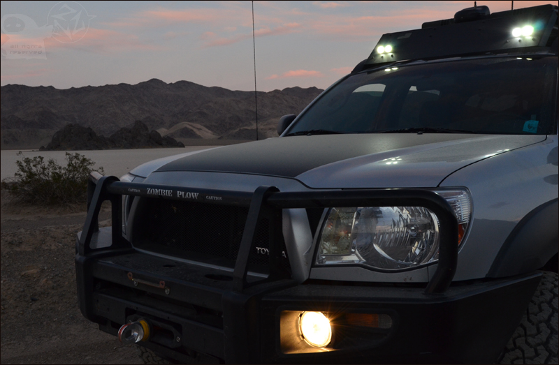

and here it was after paint and mounting the Vision X Solstice lights. I put 1 flood beam and 1 spot beam on each side:

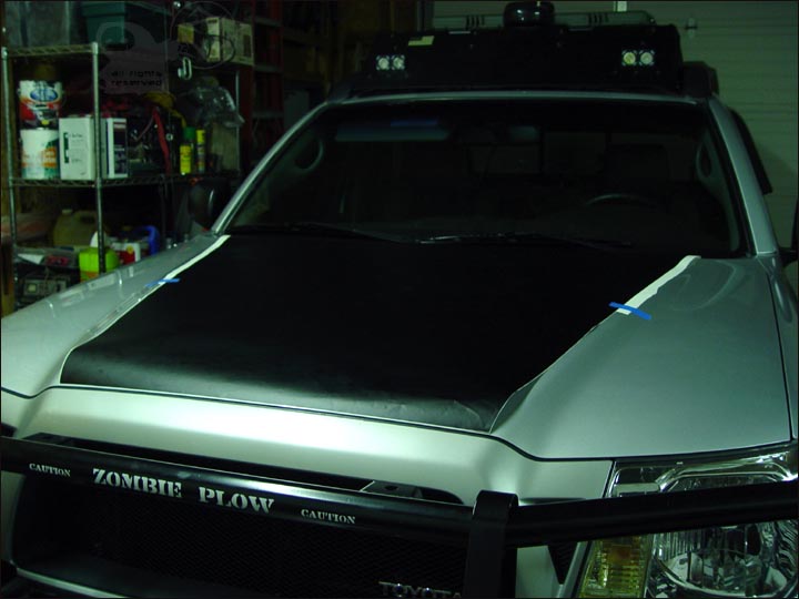

blackout hood vinyl

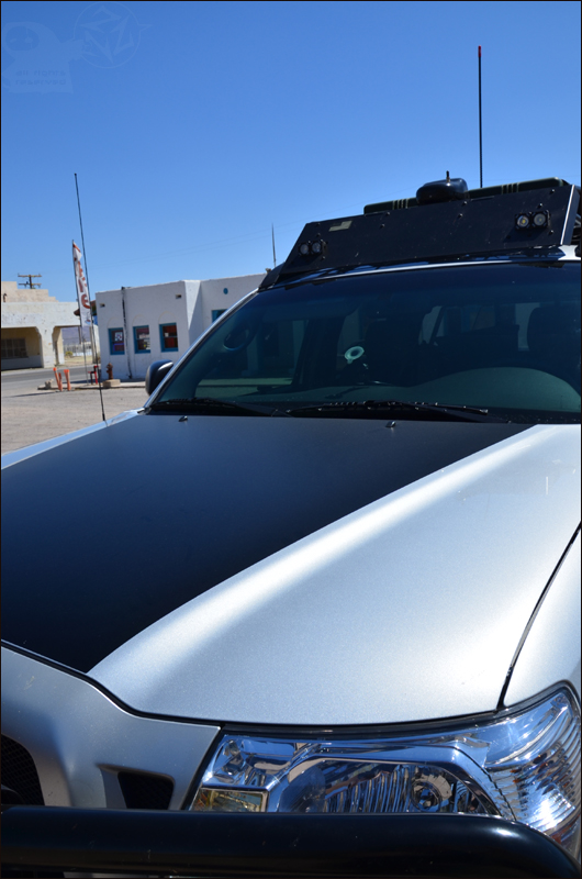

added some matte black vinyl to the hood to kill glare from the sun and the rack lights, kind of a pain to apply but works awesome!!
here's a pic while putting it on:
and here it is finished up (with some miles on it )

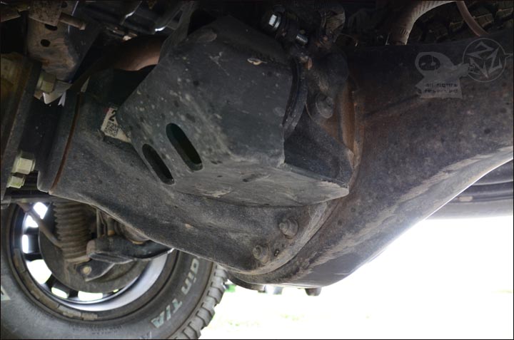

all pro e-locker guard
in a moment of prophetic clarity I added an e-locker guard from All-Pro before our recent trip to DV, and it paid for itself on steel pass haha :Wow1:

where did you pick up the vinyl? is it a DIY thing or store bought?
cheers, truck looks great
thanks! I ordered the blackout vinyl from Vigg Designs pre-cut for the hood, and while the vinyl itself turned out great I can't really recommend them due to lousy service. I'm sure you would have better luck with Crawlorado at the link Tango posted above :)
The application is DIY and pretty much requires 2 people along with the correct tools and procedure. It's a bit of a pain, but if you take your time it will turn out nice.
