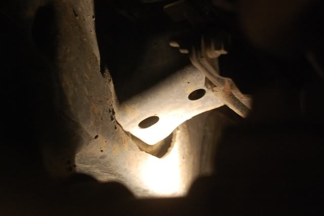

Mine FJC goes into friends shop in the AM to pull AP skid & get a better look - since I can see rust & what looks like a fracture in exactly the same area.:eek: Sure hope my eyes are playing tricks on me.
Update on mine - total BS on all counts - denied coverage on all issues.
Click on pic will take you to full size version.
ps: Big thanks to Tigger my FJ Cruiser will be wearing some custom decals.
