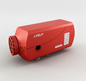

Interested in a gasoline/petrol heater, there’s lots of YouTube videos on this guy, looks very similar (at least from what I can see on the exterior) to a Webasto but at half the price
lower co2 output as well as lower exhaust temps compared to diesel. If I can figure out how to easily/safely tap into a gasoline fuel supply I like the idea of hard mounting it, I’d have no issues cutting holes in the truck bed for all the exhaust/supply lines if I could do it cleanly.
