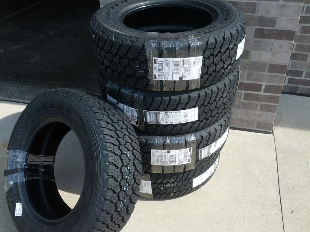

My factors were a need for load range E tires, excellent snow performance, increased side wall dimension, while not permanently lifting the vehicle to where it could not enter a standard garage. Adding ground clearance was also a consideration. Thinking a 32" or larger diameter tire requires a permanent lift. At 31.5" or less, your mostly good.
The 2013 Colorado floods highlighted that 19" and 20" wheels are inappropriate. I'm happy with the LR3 18" wheels. Even at 18", selection is somewhat limited for my needs. At 19"/20" it was a joke.
I think the reason I am not having as much of an issue is just the offset of the compomotives and the shape/size of these tires. They are AT, but are not nearly as aggressive as a lot of the others used here. You can see by the profile that they don't have straight vertical sidewalls all the way to the tread, they curve in more like normal road tires. I would guess that is why I am not having issues.
I would go and take pictures and do more scientific work on this for you all, but its still -5 before windchill here.
In general you will find that 18" LT / load range E tires start at mostly 32" diameter and larger, requiring Johnson Rods/permanent lift. General Tire offers the 285/60-18 AT2 at 31" OD while Cooper's A/T3 18" LT's start at 275/65, which is 32.1" OD, and larger. Once you sort out that first set of criteria, then all the others come into play.
Thinking LT tire selection is driven by full size trucks that have much larger wheel openings than Land Rover.
The range below 31" is dominated by P-rated; (Tire Rack - "cars, minivans, sport utility vehicles and light duty pickup trucks (typically 1/4- and 1/2-ton load capacity").
The LR4 is NOT a light vehicle, weighing in at ~5800lbs by itself. I initially had P-rated tires on the LR4. I could feel the rear end squirm towing a 19' camper as sidewalls flexed. Now think about loading up a LR4 for a long weekend/overland trip.
