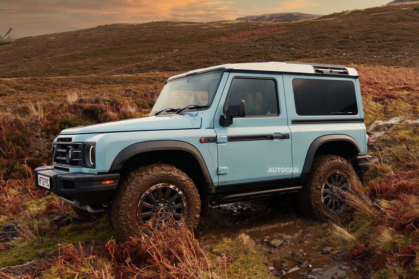

Some interesting bits from Autocar on the potential expansion of the Ineos range (which it will need to do to bring down the fleet average fuel usage)
Ah yes, and the full bling G-class variant is in the works too according to the same article. Here come the Kardashians! Can't wait to start dodging them in Park City.
